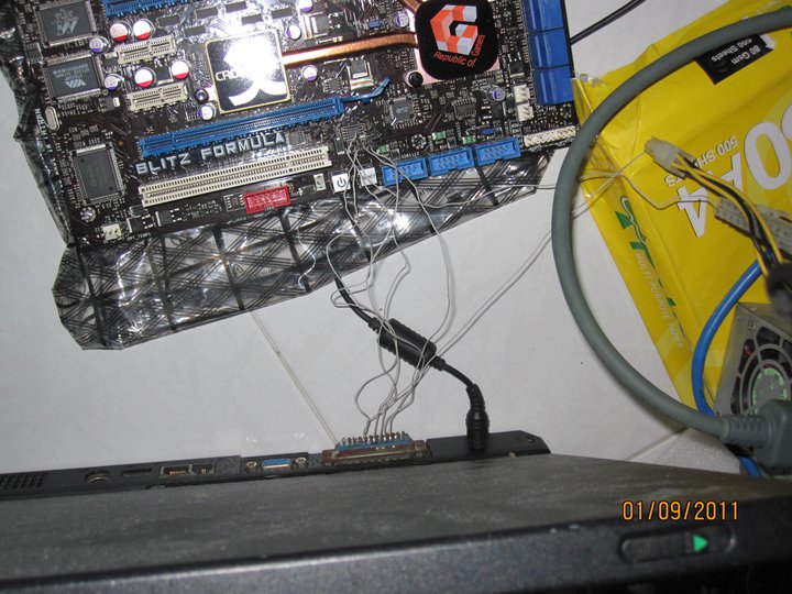

3.jpg Wired Next I wired up an LPT connector to it. The flashing app I'll be using is known as "SPIPGM2", what it does is that it bit bangs the LPT to simulate SPI. I didn't use any sort of buffer or 'protection' diodes or resistors on it, I figured it's gonna be on only for a short while and should be ok. You gotta have a LPT (Printer) port for this setup to work.

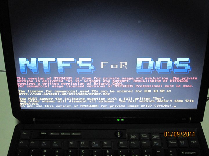

5.jpg NTFS For DOS I used a NTFS for DOS boot CD to let me read/write to my HDD that's NTFS partitioned (laptop runs WinXP). This allows me to place the necessary files (SPIPGM2 related) and then read and dump files onto the HDD. You can use anything as long as it let's you boot to DOS and can hold your dumps (Bootable thumbdrive, heck even a floppy disk).

9.jpg Hookup The hookup from motherboard to laptop, a little mess of 7 wires. 2 for GND and +3.3V, 5 for signals. Like I mentioned before, there are no buffers and current limiting resistors etc, so I wouldn't leave it hooked up forever (if somehow you decide that leaving it plugged in is a good idea).

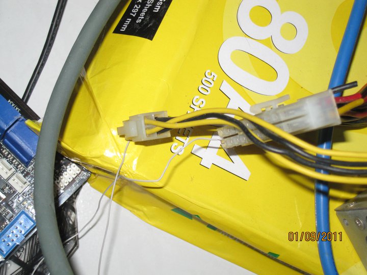

10.jpg 3.3V My 3.3V source was straight from an ATX PSU main connector. Shorting out the green (PwrON) to ground will make the PSU turn on, then probe around for a 3.3V source, it should be orange, although some PSUs might not have it in the same colour.
