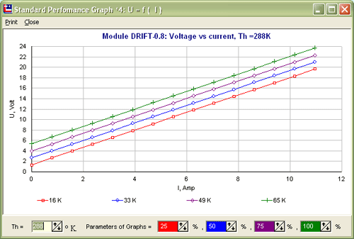

"The standard graph ¹ 4 is the function of the voltage, supplying to the thermoelectric module, vs. the current. This function is plotted at the specific values of the temperature difference between the module's sides.
The voltage, applying to the module, consists of two parts - Ohm voltage and the voltage spent for the overcoming of EMF, which appears in the result of Seebeck effect. At the fixed value of the temperature difference the Seebeck part is constant, and the Ohm part is directly proportional to the current. As the result the voltage linearly increases in the dependence of the current."
Imax=11.3A
Umax=24.6V
Qmax=172W
dTax=69(K)
στα 14V, χρειαζεται 6Α για διαφορα θερμοκρασιας 49 βαθμων (Kelvin=273+ Celsius) στις 2 πλευρες. αν ισχυει το V*I τοτε μιλαμε για 84W, και οχι για 196W (14*14, που ειναι παραπανω απο τα 172 που βγαζει το πελτιερ)
