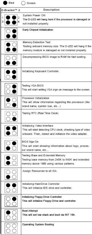

φίλε μου από ότι διαβάζω στο manual σου έχεις πίσω ένα panel με δυο extra usb και 4 led τι ποια led βλέπεις εκεί ανάμενα
τα led έχουν την παρακάτω σειρά όποτε πες μου αριθμούς
1 2
3 4
θέλω και χρώμα red green
σου επισυνάπτω τα σχόλια του manual
D-Bracket™ 2 is an external USB bracket integrating four Diagnostic LEDs,
which use graphic signal display to help users understand their system. The LEDs
provide up to 16 combinations of signals to debug the system. The 4 LEDs can debug
all problems that fail the system, such as VGA, RAM or other failures. This special
feature is very useful for the overclocking users. These users can use the feature to
detect if there are any problems or failures.
D-Bracket™ 2 supports both USB 1.1 & 2.0 specification
