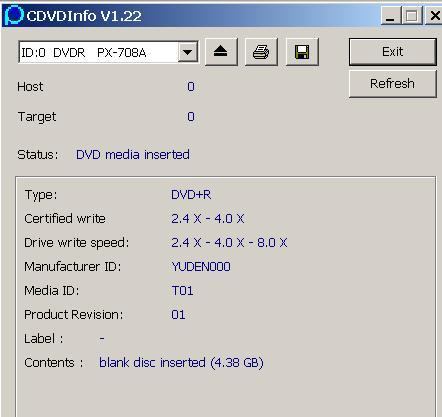

sotiris Σεπτέμβριος 26, 2004 #169 Σεπτέμβριος 26, 2004 Πρόκειται για αυτά: (για+r) EDIT: είναι από τα bulkPlextor: 708a TLA#0206 απείραχτο. --------------------------------------------------------------------------Unique Disc Identifier : [DVD+R:YUDEN000-T01-001]--------------------------------------------------------------------------Disc Type : [DVD+R]Manufacturer ID : [YUDEN000]Manufacturer Name : [Taiyo Yuden Co. Ltd.]Media Type ID : [T01]Product Revision : [001]Disc Application Code : [General Purpose]Recording Speeds : [1x , 2.4x , 4x]Blank Disc Capacity : [2,295,104 Sectors = 4,482.6MB = 4.38GB (4.70GB)]--------------------------------------------------------------------------** INFO : Hex Dump Of 'Media Code'-Block Listed Below** INFO : 4-Byte Header Preceding 'Media Code'-Block Discarded** INFO : Format 11h (Method 1) - ADIP Information0000 : a1 0f 02 00 00 03 00 00 00 26 05 3f 00 00 00 00 .........&.?....0010 : 00 00 01 59 55 44 45 4e 30 30 30 54 30 31 01 38 ...YUDEN000T01.80020 : 23 54 37 10 02 4e 72 02 9c 63 16 16 0b 0b 0a 0a #T7..Nr..c......0030 : 01 19 1b 0b 0b 0e 0f 01 00 00 00 00 00 00 00 00 ................0040 : 01 00 38 38 02 2c 63 20 08 30 22 10 00 20 20 01 ..88.,c .0".. .0050 : 00 00 02 2c 63 20 08 30 22 10 00 20 20 01 00 00 ...,c .0".. ...0060 : 00 00 00 00 00 00 00 00 00 00 00 00 00 00 00 00 ................0070 : 00 00 00 00 00 00 00 00 00 00 00 00 00 00 00 00 ................0080 : 00 00 00 00 00 00 00 00 00 00 00 00 00 00 00 00 ................0090 : 00 00 00 00 00 00 00 00 00 00 00 00 00 00 00 00 ................00a0 : 00 00 00 00 00 00 00 00 00 00 00 00 00 00 00 00 ................00b0 : 00 00 00 00 00 00 00 00 00 00 00 00 00 00 00 00 ................00c0 : 00 00 00 00 00 00 00 00 00 00 00 00 00 00 00 00 ................00d0 : 00 00 00 00 00 00 00 00 00 00 00 00 00 00 00 00 ................00e0 : 00 00 00 00 00 00 00 00 00 00 00 00 00 00 00 00 ................00f0 : 00 00 00 00 00 00 00 00 00 00 00 00 00 00 00 00 ................--------------------------------------------------------------------------[DVD Identifier - http://DVD.Identifier.CDfreaks.com]--------------------------------------------------------------------------
